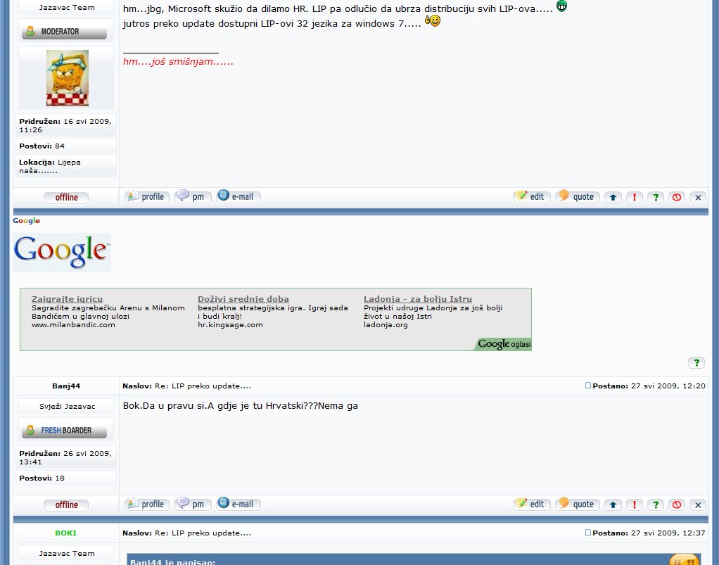

Thank you Methusala,
but with this code i have adsense like in the picture,
 please check picture. Maybe change some lines to get ads on right, after "Google" picture, not below?
I'm begginer, so...

Save this image and upload it to Styles > Template > Theme > Images
